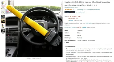

Only problem with a steering wheel lock is that most people probably put the key on the same key ring as the van key for convenience.
Battery powered angle grinders, wrecking saws and chainsaws have given the thief almost limitless capabilities, a piece of steel isn’t an issue.
