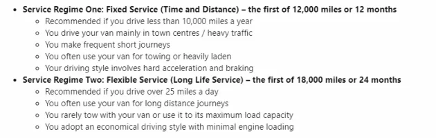

I called my local VW commercial service department to book an appointment and they explained I should wait for and extended message which would include 'Oil or Service', whereas my current message is 'Inspection Now'. She explained I would therefore pay for an inspection and recommended I wait. Having checked the VW Service History she confirmed the van received a Service in January 2020.
Is this the correct approach? If so, should I reset this message?
go into your MFD and see what it says . . https://www.t6forum.com/threads/mfd-service-interval-confused.9330/
then compare it to the oil/full . . . small/large service interval.
how many miles has the van done since the jan 2020 service? --- it may just be that it was set to an automatic 12mnth reminder, and and not based on miles driven.
I purchased the van following a new conversion in August 2020 with 10k miles, so not sure of the miles completed since the service in Jan - I'll go and check the MFD.
Checked MFD. Assume all okay for now, no service required. How do I reset the inspection interval?
If you reset via the MFD you will set the 12mnth service interval.
Vcds can clear just the inspection message, but it’s there for a reason you should still have it inspected annually that does not mean a full service

I've just been through this thread and still confused! I bought the van almost a year ago with the service plan of 2 'free' service. Inspection in 30 days is now showing. Is the inspection deemed as a service, i.e. uses up one of the two included in the service plan? It shows service in 145 days. 3 years old last week and 28000 miles. Thanks.
No,it's not a service.
Although the woman on the service desk tried to charge me for one..when booking in.
All sorted on the day..and performed,gratis.
As I'm on the time and distance regime, I get serviced annually, so my inspection normally coincides with the full service.
