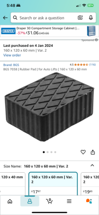

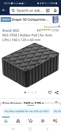

My current one since Jul 2022 is a brick style 60mm thick pad (Amazon.de) and so far it seems to be the best of the bunch. Although it doesn’t neatly fit the trolley jack cup it doesn’t seem to matter, never felt unsafe lifting with it. And no, I don’t sell those bricks. ;)
Previous one after some T6 treatment and the brick after 2.5y of use

My current one since Jul 2022 is a brick style 60mm thick pad (Amazon.de) and so far it seems to be the best of the bunch. Although it doesn’t neatly fit the trolley jack cup it doesn’t seem to matter, never felt unsafe lifting with it. And no, I don’t sell those bricks. No

which as you can see has a slot that would fit the factory lip that the factory scissor jack fits. Where exactly would you jack up the van with that brick?

I thought so as well but having gone through a bunch of those I haven't found one that would take the weight of Transporter front without being right out dangerous after a year or two.
Why, under the official jacking points of course - circled in red in post #1 of this thread. Or sometimes under the subframe if I need to get the front on jack stands. Or sometimes under the support arms when I need to get the rear on jack stands.
