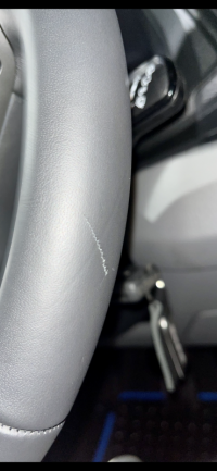

I’ll be interested to hear what VW has to say about it once it’s all sorted. Hopefully I might be able to get something out of them as a goodwill gesture. A couple of other things i’m not pleased about. I caught the end of the key on the steering wheel and it’s scratched the leather. The end of the key is sharp with jagged edges. I don’t get why they would put LED lights all round and then use halogen lamps for fog lights on a highline model.
