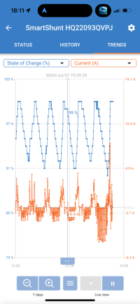

I’d still question your need for such a big box. How often will you need to charge on EHU? As an indication the graph below is the solar recharging over the last few days with my fridge on 24/7. It was warm so working hard(ish) and obviously plenty of sun. The van was driven on one day but the DC-DC was turned off - and Bly charge was the solar. Doors opened regularly and AMT working hard with a dying SB. As you can see the LB never dropped below 91% each day (that was in the early morning) and was recharged by about 10am (the van was still in shade then). Even with fridge, heater, lights, USB chargers running the solar has always topped up the LB during the day regardless of weather. Even with zero charge I’d get minimum of 4 days from the LB at max use. If you drive the van every few days then the situation is improved even further. I simply see no need for the mains charger unless you are using an inverter and have big power needs (or use EHU all the time, in which case why bother with lithium?).
