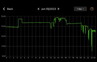

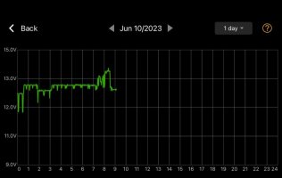

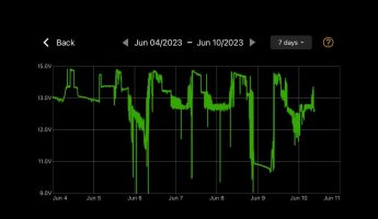

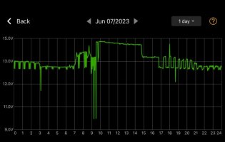

After issues with my starter battery (which now seems to be OK), I reckon my leisure battery is probably knackered. On our first night away (last Monday) we were not on EHU and although the battery was fully charged from the 200 mile journey to Ashford, shortly after stopping with the fridge and light on, my plug in 12V battery meter thing stated showing the battery as being very low (6 - 9V but jumping momentarily up to 11V) and the fridge wasn't working properly. We were on EHU for the next 2 nights so no problems but on Thursday, we were again with out EHU and the same thing happened. The battery seems to be charging from alternator, EHU and solar but is simply not keeping the charge so I can only conclude that it needs replacing - It's a Leoch Extreme AGM 110Ah which is 4 years and has never been allowed to run flat and has always been maintained by either solar or a smart CREK charger. FWIW, these are pictures from the BM2 batter monitor app showing it's history over the last week (the summary of the week and individual days):
