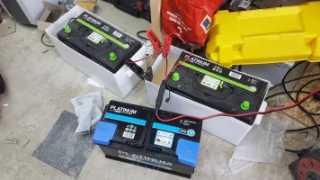

The plan is to use it to top up these beer fridge batteries . . . .

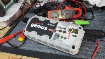

which are currently charged up with this NOCO charger . . . .
Because it seems like the Euro6 smart alternator system just doesn't charge up the batteries properly....(leisure battery connected in parallel with the main starter battery with jump leads)>
with our old T5.1 all we done was connect a set of jump leads and let the old van run on tick over for half an hour . . . . . 13.8v and all was well.
It doesnt work like that with the T6, and also had the same thing with me dads Mazda SUV, he had the batteries connected together and run the car for 45mins . . . . . basically it put no charge back into the leisure battery. =[

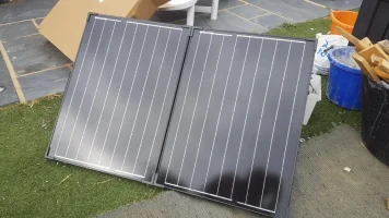

Its finally arrived........
the renology 100w suitcase . . . . .
It comes with a fairly decent looking PWM charge controller. . . . . . .
2x panels . . . . 100w total

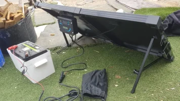

just had to plug it right into one of the leisure batteries for a test . . . .
Seems its generating 0.9A with the sun behind some clouds . . . . . and was at 1.7A just before with a small bit of sun.
Free Energy . . . . . =]
The start of my Solar adventure has begun . . . . .
Edit- Sun has gone in now so its a grey over cast day . . . . . . . But the charge controller is still showing battery charging at a rate of 0.3A.. so still generating power. only 300mA but thats better than nothing right.
