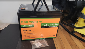

Did I mention i bought a ECO-Worthy Lifepo4?
this was OCT/NOV 2023. . . . but looks like i missed doing the post?
100Ah 12.8v
Right, so getting back to this. . . ECO-WORTHY 100Ah Lifepo4
while abroad sunning it up in Spain for a while this popped up. . .

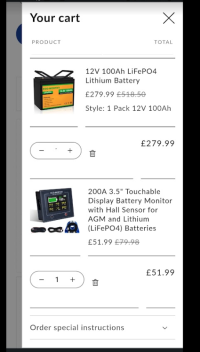

£279.99 seemed like a good deal, so i got one.

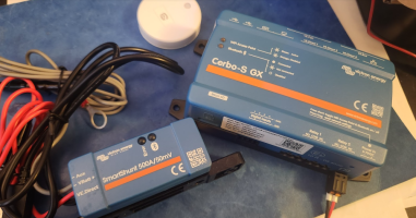

and that Shunt looked nice to, and as these battery's have a BMS, but no BT or screen, i though id get that to go with it.

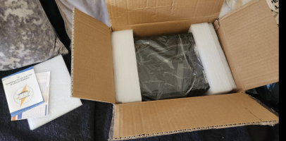

back home in Blighty this is what arrived . . .
a well packaged lifpo4 . . .
it come with a set of bolts, and a install guide . . .
3000+ cycles,
10 yr life span,
built in BMS,
12.8v 100Ah - Lifepo4
its good to see the info of the lable on the battery. . .
and they make good point about charging and discharging outside of these temps. . .
NO Charge below 0c.
No discharge below -20c.
this is because, as far as i can see there is no LOW TEMP Protection in this battery. . . . . .
No charge blocking - Nothing.
Its down to you to ensure your setup has the required cold temp protection.. . .
Low voltage protection, not tested yet - the sticker shows 10v - 14.6v.

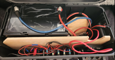

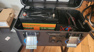

the first thing i do is get it into one of my battery boxes, it fits nice.
a slightly different shape than the Renogy and Poweroad - but fits all the same.

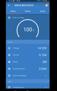

the battery box already has a Victron Smart shunt fitted - so ill use that for monitoring for the meantime.

this is it dropped into the battery box and linked in.
we have the 50A MIDI fuse block,
with 50A Andersonn conectors for IN & Out,
plus the Victron Smart Shunt for voltage and capacity monitoring. . .
then we get it right on charge from the solar shed.

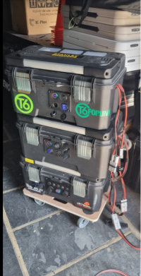

its been added with another two battery boxes.
they hold the HEATED Poweroad 100Ah lifepo4`s.
and are all connected together. . .
we have three 100ah stack giving us 300Ah for the solar shed.

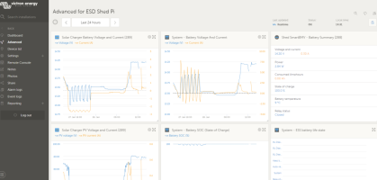

that's all charged via the 100/20 MPPT Victron unit, with 400Wp solar up top.>
monitoring is via the Victron shunt . .

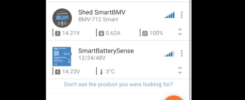

temp control is an issue as the Eco-Worthy doesnt have low temp protection. . .
so while the battery is connected to the stack I've set the 100/20 MPPT solar charger to default LIFEPO4 charge profile.
this profile limits charging below 5c.
BUT. . .
i doesn't have its own temp sensor, you need to add one,
i have a smart battery sense and a temp sensor on the Smart BMV that shares the temp data, , ,
that means it wont charge when its loo cold. . .
