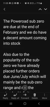

Out of stock :(
As soo as these come back into stock I think I’ll order one, such a neat solution. I might flog my Valence to offset this or I might keep it for other projects.
@andys yes the charger was set for 30A but only drew 6.7amp. Once the temperature hit 5c it went up to 23A.
I ordered and paid for mine in December, which meant that when they arrived in stock last week it was set aside for me.

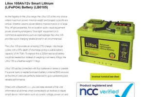

Thanks @Dellmassive...just out of curiosity what kind of life expectancy would you expect from a Lifos assuming its treated correctly during its lifetime?
LIfos 105Ah - they saying upto 10years "trouble free operation." with a 5 year warrenty.
2750 discharge cycles @ 25degc @ 90% DOD
3500 discharge cycles @ 25degc @ 75% DOD
5 year warrenty.
5 year warrenty.
Brilliant , thanks mate.:thumbsup:
