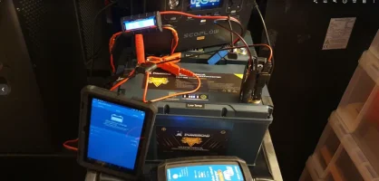

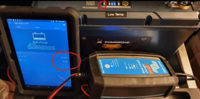

POWEROAD Infinity PRLC-100-LT ‘Sub Zero’ - SLEEP MODE
more testing regarding sleep mode . . .
@Mick asked me "does the POWEROAD battery still charge in sleep mode?"
well lest find out . . . . . . .
heres the setup.
were using the ECOFLOW RIVER PRO : https://www.t6forum.com/threads/solar-generators-how-i-done-it.27616/post-384185
to provide mobile 240v for the VICTRON BSC 15A battery charger.

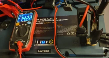

the battery shows about 80% full.
when we start the charger up we can see 252w being pulled from ECOFLOW 240v side for the Victron BSC charger to generate the 15A of charge current into the POWEROAD battery . .
we can see this on the battery APP and the inline power meter . . 15A going into the battery.
so the battery is charging up at the full rate of the charger . . . 15A.

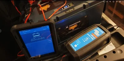

at this point i tried pressing the SLEEP mode button . . . . nothing changed.
so i disconnected the battery APP & BT - again no change.
we can sere the APP has disconnected and BT light has gone out, but the battery's is still drawing the full 15A from the charger.
the SLEEP mode button still didn't do anything while the charge source was supplying power..
it was ONLY when the charge source was removed that i was able to get the battery into SLEEP mode . .
once the battery was in SLEEP mode, i reconnected the charger . . Nothing changed. (edit - on this occasion)
so the battery was now ignoring the charge source and defiantly sleeping . . and NOT charging, even though the charger was connected.

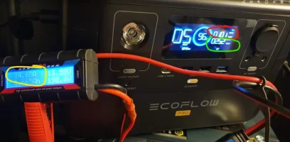

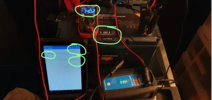

Now for the interesting part . . (edit - on this occasion)

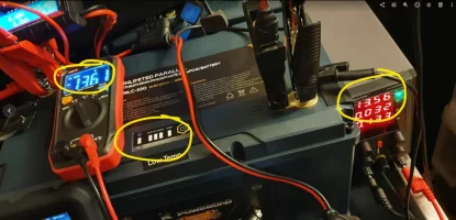

at this time i connected the battery to the 12v input of the ECOFLOW, it will take 12v in @ 8.5A to charge its self . . . .
as soon as i made the connection the battery it jumped out of SLEEP mode and come back to life without me touching the SLEEP button.
we can see the cyclic power flow . . .
you can see the ECOFLOW delivering 252w into the 240v mains BSC charger, (green circle)
that is charging the POWEROAD battery at 13.5v 15A (yellow circle)
that is powering the ECOFLOW 12v @ 8.5A 101w input charge circuit . . (RED circle)
round and round and round and round we go . . . . . . . . . . .

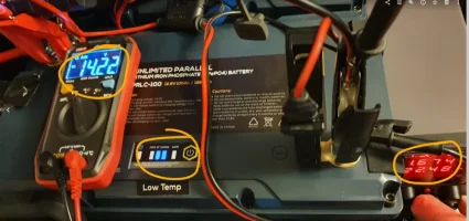

so here we are back to the start again . . . . .
with the battery powered up and receiving a charge again from the 240v BSC Victron . . .

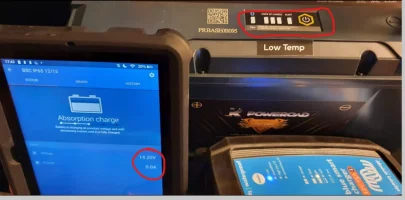

BUT . . . . .
on the second test around, things changed . . . !!!
test #2
again it wouldnt sleep unless the charge source was removed. 15A in.
it would let me sleep when it was delivering 8.5A out,
reconnecting the 8.5A out wouldn't bring it out of sleep
but reconecting the 15A charger DID bring it out of sleep.
HMM . . .
test #3
reconecting the 15A charger didnt bring it out of sleep.

Lab PSU out for testing.
here we can see that feeding the battery while sleeping with an adjustable voltage . . .
at this point its 13.61v - battery sleeping.
10mins and 20x samples later we have life . . . .
at 14.22v the battery BMS switched the battery on and comes out of sleep mode.
this can be repeated again by using the Victron BSC in power supply mode . . .
the charger delivering 14.02v - no change, battery sleeping.
BUT . . .
as soon as you hit 14.22v
the battery comes to life....
ok conclusion time. (reverse engineering the BMS Firmware programming)
testing shows that . . .
battery wont sleep unless the charging source removed. (untested Amp threshold/trigger point possibly 1amp and below tbc)
battery will let you SLEEP it when its delivering power.
reconnecting a charger source of above 14.22v will bring it out of sleep.

POWEROAD Infinity PRLC-100-LT ‘Sub Zero’ - TOP Charging.
Setting the Victron BSC to 14.4v BULK charge, as per the above spec sheet . . lets see what happens.
The Victron BSC is set to custom mode at a 14.4v BULK limit set. (and 15A max)
we can see the current here on the battery APP, 14.98A, and the voltage of the battery, 13.47v . . that will gradually rise to the 14.4v cutoff point.
ETA from here is shows @ 15A to be 57mins . .
TBC . . . . . .
interestingly the APP shows 100% . . . . but the battery is still taking the full 15A.
the charger carried on . . .
untill the current drawn started dropping . . .
finally down to 0A and showing 100% ( with the charger set to 14.4v )
checking the battery APP logs it flagged on battery cell over voltage.. roughly at the 100% point.
