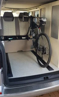

Ordered a Smartbed Evolution R just after Christmas and its just turned up mid Feb, I thought it was going to be longer so nice surprise!
Pick up day! Richard at Berkshire Campers fitted the Smartbed, laid the wood effect floor and fitted my solar panel.
I went for the Evolution R as it comes on rails and you move the seat right forward so you can still use the back of the van and if you have passengers behind you can move them forward so they are not right at the back of the van.
Really pleased with the results..
The rails are not my favorite part but it is what it is..
You get a little seat at the back.. Great for me to sit the kids on and put on their shoes.
Also, storage for bedding and an awning when on the move.
Its certainly going to be snug on there!
Room underneath for a surfboard.. and maybe a Porta Potty.. I need to measure.
The seat in its most forward position.
Its a big old unit!! My one has grey sides.. Some of the ones I have seen have a mirror finish on the side. Like the plain colour.
Still loads of room to put stuff behind.
The cable is from the solar panel that I need to cable up.
Can't wait to get the furniture in now and start using it!

I was after a cheap protective cover for when a dirty mtb is in the back.
This is just what I want to do. Just mine is a SWB so might not have the space. Does the seat come off easy?
My seat cushions are custom made and weren't supplied by Smart Beds. But the box section that they're fixed to has four screw holes, so I'm sure it will just be a case of unscrewing them. I'm planning on making a sleeves to fit over the box section and fitted to the base if the seat, to make removing the buddy seat a quick operation. Your floor rails will be longer than mine as I have existing factory seat brackets still in place. So your seat will slide further forward. Even though yours is a SWB, you may get bikes in and have enough leg room for rear passengers. Time to get the measuring tape out.
I’ve just been out and had a look. Yep 4 bolts it looks like holds on the small seat.
Not a plate to go on it the mounts attached. I’m assuming that’s how you’ve done it on the first place.
Need to wash the mtb first and see how much room I have.
