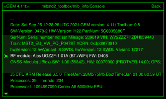

So, a bit of time spent on the WiFi issue this afternoon. My intention was to force the D408 Bluetooth firmware on to the unit, but having checked with MIBStd2 toolbox (MIB_info option) it already identified as a UGZZF-1 01A with FW D408, even though the menu system (Version info or similar) says it's a C300. So the issue is not the wrong firmware being installed, it's the rest of the firmware only expecting to find something running C300 firmware.
The good news is, you can check either via MIBStd2 toolbox or the settings menu as to which version Bluetooth module you have. If it's UGZZF-1 A1A / C300, you're good to go. If it's UGZZF-1 A1A / C194 , I believe it *should* update OK to C300. If it's UGZZF-1 01A / D408, it's no good unfortunately, you'll lose WiFi when upgrading to 0478.
My unit is HW version H22, I have not yet checked my newer unit to see what version that has, but it will be a H3x HW version. My intention is to fit the newer unit in the van soon, check the Bluetooth version, load 0478 and see what happens and report back. It would be good if we could get a list going of which Bluetooth module we have fitted and which hardware revision we're on, just to give prospective upgraders/DM purchasers an idea.

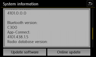

Without MIBStd2 toolbox, you can try this, however, it did not work with my new unit on 0361 firmware.
Menu > Settings > System Information > Scroll down to 'Bluetooth Version'
This has only worked on my 0478 unit so far, and it only says the version the software is set up to use. So it's only actually accurate if your WiFi is currently working.

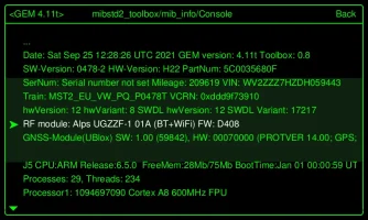

The best way is to install Mibstd2 toolbox, and then follow the following instructions:-
Enter GEM > Mibstd2_toolbox > Mib_info > Show short system info. It will fill up various pages with information, scroll up to the first page and look for "RF Module".
It should show one of the following three:
  • Alps UGZZF-1 01A (BT+WiFi) FW: D408 - WiFi will NOT work on 04xx software
  • Alps UGZZF-1 A1A (BT+WiFi) FW: C194 - WiFi SHOULD work on 04xx, and it SHOULD update to FW C300, I will prove this later today on my own unit [see update]
  • Alps UGZZF-1 A1A (BT+WiFi) FW: C300 - WiFi will work on 04xx software
