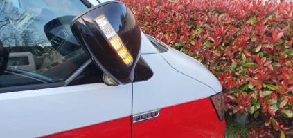

Hi guys , I have also done this mod , well chuffed with the finish. The issue I have is that when I switch the engine on the indicator stops working , I bought some resistors to try and sort this issue but still no joy ? Have you guys got any ideas how to fix this ??
Hi guys, I have also done this mod, well chuffed with the finish.
The issue I have is that when I switch the engine on the indicator stops working,
I bought some resistors to try and sort this issue but still no joy?
Have you guys got any ideas how to fix this??

Some from eBay , bought from this country so I thought I would not have an issue ? Wgat can I do to sort it ? I have bought some resistors but they don’t seem to have worked ? See pic of indicators
You shouldn't need any resistors assuming that you have switched from OEM side repeaters to those LED stripes.

Box has long gone unfortunately I have tried swapping the wires ? Not great with electrics so struggling to sort it ?

I have gone from normal bulb indicators to led sequential indicators , but they don’t work when engine running
