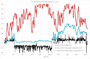

If you want to do some reading have a look at some of his posts and you will get the idea
As a starting point some good setups below
Also quite a few engine build-in diagnostics tests that can be run for further analysis by VCDS - extremely powerful diagnostics tool.
Anyways, more than happy to help to try to analyse data files

Thanks mmi. A lot to get my head around but I’ll do some reading. Looking at those plots baffles me at the moment. I’m more used to working on things with carburettors
