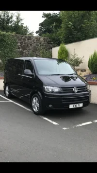

I also need spacers on my T28 Highline camper...the wheels look too 'under the van' at present and I want them level with the side of the van.
I also understand that I may need shorter bolts? Unless the bolts go all the way through the spacers into the hubs...currently got 18" highline alloys which I quite like and don't want to drop it as we go over rough tracks when we get away in it.
Those spacers look just right.Can i ask who you bought them from, did they know which bolts to send for the front ? Ta.
Hi. I got them from here
https://www.dcperformance.co.uk/cheap/780845/volkswagen/h_r-trak^-wheel-spacers/3075650.html
Volkswagen T5 25mm H&R Spacers 5075650 Only £117.17
The rear spacers has everything in the kit. You bolt spacer to hub using counter sunk bolts supplied with kit. You then put wheel on to spacer & use the shorter 19mm head bolt that also comes with the kit.
For the fronts you need 10 longer bolts which are not supplied with the kit. I purchased mine on eBay. Item number: 371480896286
