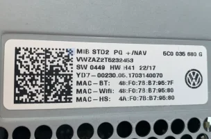

Hi everyone,
Great topic here and I am currently looking at fixing my dodgy touchcreen as well but I have a small question for you all.
I read through all the messages here and you all seem to have a different reference number on your radios than me.
My reference number is - VWZAZ2T6232463
Photo attached.
Am I still ok to purchase one of these like you all have? - TDO-WVGA0633F00039, TDO-WVGA0633F00036, TDO-WVGA0633F00045
Thanks for your help!!!!
Hi @Daryl82
The 00039 & 00045 numbers are found on the back of the screens.
The VWZA… number is that of the whole unit.
Hope this helps.
Andy
