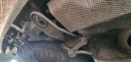

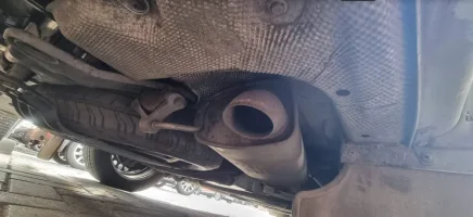

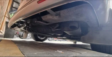

Hoping someone on here can help me! I've tried to search on the forum and found Dellmassive's image of a parts diagram but I'm not sure if the part I'm looking for is on there.
I was giving the underside of my 2016 T6 Transporter a good wash today and noticed what appears to be a missing section of undertray at the rear offside/drivers side - not sure when or how it disappeared! It would be the section above the exhaust, behind the wheel, from the side across to the the section above the spare wheel space. There don't appear to be any remaining "broken" off parts so I'm assuming an entire piece is missing. See picture...
I've been searching on-line for about an hour now and can't find any helpful info or images of parts that look lie they could be right. If I had a part number it might be easier.
Could it be part 27 in this diagram, although that looks like nearside (confusing!) and the proper part number isn't available in the image?Parts diagram.png
looking at mine... MY18
and looking at yours, MY-2016
you have the SHORT exhaust,
i have the LONG exhaust, . . . so i have the extra heat shield for the rear box.
is that what your talking about?
or is there a plastic black under tray you think you are missing?
whats the van spec?
im not sure you are missing an under tray - but it looks like you are missing a spare wheel though?
