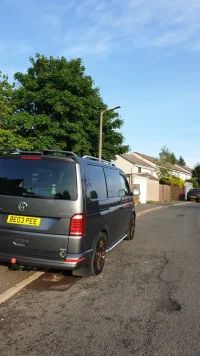

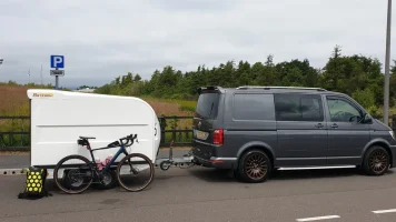

Thank you - do you have a photo of your van with them fitted? Love to see. Regards PaulThat's what I run and they are perfect
Lots earlier in this thread.Thank you - do you have a photo of your van with them fitted? Love to see. Regards Paul
Of course. Thank you. Have pulled the trigger.Lots earlier in this thread.

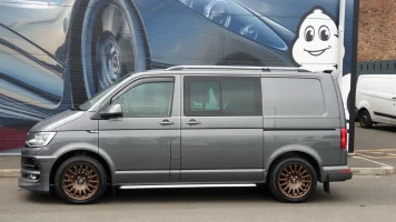

They sure look good. Will one of those new wheels fit in the spare wheel space?Joined the clubDelighted with the fit of these. These are on a Caravelle 4mo with standard suspension.
Thanks all that have shared info and made choosing these fairly straightforward (hardest choice was colour - played it safe in the end).
For reference, I went for Pirelli Scorpion AT+ in 235/65R17 108H on these which are of course 17" x 8" ET35. As previously advised by others, my speedo is now a total match for gps through the range. Fitment appears tight in places but no rubbing whatsoever. Significantly more comfy than the 18's I had on too.
Centre bore on these is direct fit, however certainly my alloys are tapered seat so couldn't use the factory bolts.
