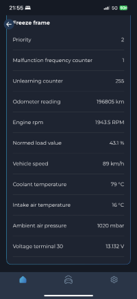

In the last 2/3 weeks my 2019 Kombi (CXEB) is showing these faults in Carista. I've cleared them & they come back. One of the faults appears then the other. So far never both faults together.
Previously a few months ago the EGR pipe was changed because it was split but not the cooler part of EGR.
I'm seeing DPF regens about every 150 miles or less & mostly doing long journeys over 1 hour.
Feeling a rumble on idle last few months but I thought this might be the flywheel.
What further troubleshooting steps can I do myself to figure out what's the issue?
P20EE - please verify that engine controller software is up-to-date.
Please post "Detailed ECU info"-report (under Carista Service menu).
P0401 - you could run engine's self diagnostic routine to verfiy the issue
