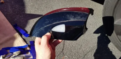

And again, I have been PMed few times regarding mirror puddle lights so I am posting this here.
I have connected both mirror puddle lights directly to the main ceiling light(both + & -).
These are the LEDs available on eBay directly from UK.
FOR VOLKSWAGEN SCIROCCO 2009-14 18 BLUE LED UNDER MIRROR PUDDLE LIGHT LAMP PAIR | eBay
Once I cut the opening(by drilling 3 holes, then jigsaw and then sharp knife) I have used clear silicone to glue the light in place. It sits flush so looks almost like factory fit.;)

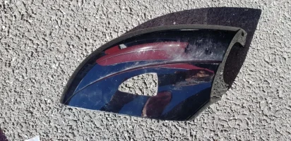

I have a broken mirror assembly, just need to find a repeater that sort of fits, to give it a go.
