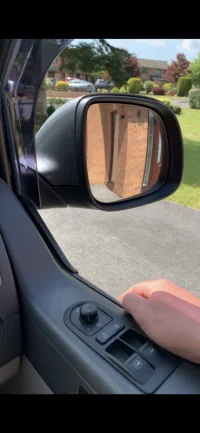

The mirrors open when opening the van, as soon as I turn the engine off and pull the key they close? This is with the switch in the L position? There is a jumper position on my module so maybe I’ll try this to see what other function it gives. With the switch in the mirror fold position the mirrors open when opening the van and close when locking. Do you keep your switch in this position?
Mine lock and unlock / open and close from outside the van ok. But the mirrors close when turning the ignition off. My switch is different to that one tho?
Think it could be the switch not having a 0 position, with the switch left on the wing mirror close position it opens and closes from the key fob no problem, with it left in the L position it auto closes the wing mirror when loosing the ignition signal. C7E1A905-B0C8-4F7F-BA23-E34DB0CCF77C.jpeg
c7e1a905-b0c8-4f7f-ba23-e34db0ccf77c-jpeg.71685
You have T5 and mine is T6. Switches are different but both have exactly the same functionality.
Lack of "0" position on yours makes no difference.
I suspect that you didn't connect your wiring correctly.
