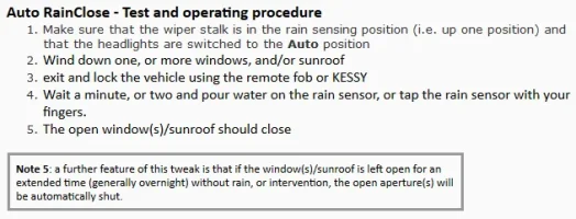

Meanwhile... in case you've missed a few links about coding challenges on another platform below. These are fairly old but as the electronics on T6 are fairly old there seems to be some commonalities.
---> VCDS (VAG-COM) codes and programmable options for Golf Mk7 - Page 23
---> Help for Rain Closing | OBDeleven
Also some data of rain/light sensors installed on T6:
It seems that the six digit string right after "RLS" is build date (as "270519" above) and the rest are presumably software revision.
EDIT: The coding difference above is because of heated/non-heated windscreen.
For the experimenting a quote from the link above:
I think it would be useful for trials if we could create artificial rain e.g. a cloth on a stick touching the sensor. Anyone to verify if it works when wipers are on with ignition/engine on?

the thing that stands out to me is amount/duration of water needed on the sensor - if i was testing that, i would have used half the water, seen it didnt work and moved on. =] (and prob missed the result with correct coding etc)
There is no coding for the amount of water to be poured nor duration of the rain. If the sensor detects water(rain fall) it closes all windows immediately.
Your impression is only the result of how rain sensor detects rain.
I have performed number of tests and windows close once the first drop of water lands on the sensor.
