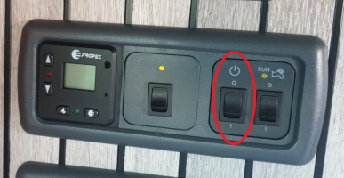

I don't have any documentation re the [currently redundant] switch, just a pic for you...
I’m no expert on camper installs but I would think the boiler is running off the 240 volt system and is probably around 1.5 to 2KW so about 8-10 amps. That switch looks to me like a low voltage (12v) switch so not suitable. Maybe some boilers have a low voltage control system but yours looks quite basic to me. As I said I am no expert on this so don’t take my word for it!!
Reactions: Bav
Yes, it runs off 240v. Frustratingly, I have no spec. sheet for the boiler, but the user manual reads as if this is usually used in a domestic setting.
Yes I was thinking it’s a domestic boiler- can you see how it’s connected to the supply- 13a plug or hard wired? If it plugs in you might be able to use something like thisIMG_2722.png
I'd agree with you @Alster that doesn't look like the type of switch you'd want to be switching the likely load.
