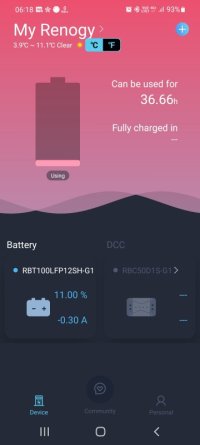

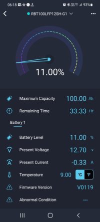

Bt-2 for the DC-DC is a must imho..... For monitoring and also changing settings.
The smart version 100ah (that I have). Also needs a bt-2 or hub.
I have 3* bt-2 units.... One on each device... Didn't go for a hub as they are all mobile units.
The newer 100ah with built in BT-2 is untested.. and has a 24hr sleep mode.
Screenshot_20220223-061823_DC Home.jpgScreenshot_20220223-061815_DC Home.jpgScreenshot_20220214-061023_DC Home.jpg
