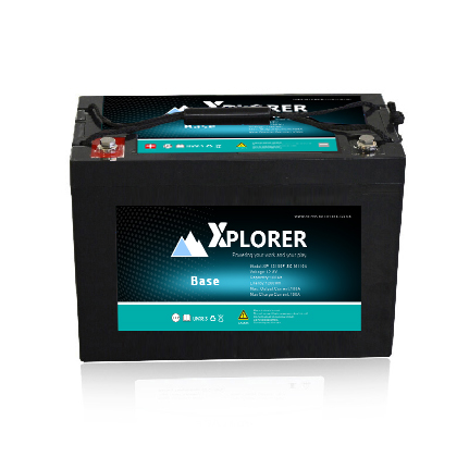

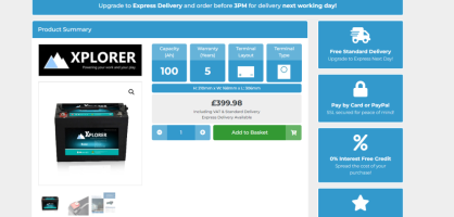

I see that there is also the option of the Xplorer Base 100ah Lithium LiFePO4 Battery, which is currently 400 quid. It seems under-seat friendly, has BMS, 5 year warranty and greater than 3000 cycles. Any body care to share their opinion on this?
Thats a new one. . . . . ill check it out . . .
looks like NO BT or Monitoring on it though.

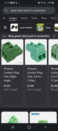

You don't happen to know what the sensor connector type that Renogy use is do you? I wanted to make up a cable for the Battery Voltage Sensor but not sure what the connector is.
Thanks, @Dellmassive. I thought it was okay but wanted to check.
You mean the green 2pin plug?
They have ditched it in the newer units.... But you used to get one in the older packs.
They ditched it as you don't need it... The idea was to measure accurate voltage on remote battery banks.
But I think they have tweaked the FW on the box and done away with including the cable.
I think they are called a phoenix connector...
But there are loads of different sizes.
For mine, its listed as an optional extra. I did wonder how much use it acutally would be given the unit is connected to the battery already. For additional battery banks makes sense. Good to know the name though! Once again, thanks for the info.
