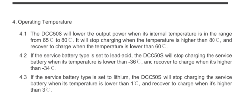

@Dellmassive , I know this is sorted now but am I right in saying that the temperature sensor shouldn't be used on this type of battery?
the DC-DC charger , temp sensor should be used for all types . .
with SLA battery's its used for charge temp coefficient ( ups the voltage when cold)
and with Lifepo4 its used to LOW TEMP charge blocking. ( incase you have a battery who BMS doesnt have that feature)

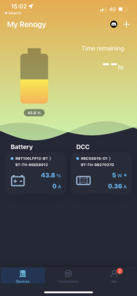

so it looks to me like the battery is 47% soc. . .
the charger is showing BULK. . . (green) so requesting full charge. . .
the battery is 13.5v (red) - so ready to take more charge.
but the engine charge shows 0A (yellow) so not charging from engine at that time.
but is showing the starter battery voltage at 12.6v (blue) - so its seeing the starter battery.
and you can see that the charger is trickle charging at 8W from solar - (pink)
from the above its shows battery around 50%,
engine is OFF,
and solar is very poor, so cloudy or dark.

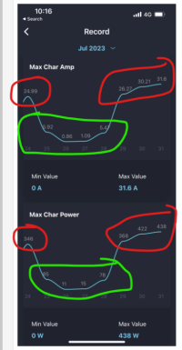

and as you say . . from the histrory it looks like you are charging. . .
these red traces seem to show engine charging.
and the green show very low solar charging . .

that says dont use, but depends on what BMS and battery you have. . . in any case it wont matter or hurt anything.
with lifepo4 setting it will just block charge to the house battery if the temp drops below 0degC.
so no problems. . .
FWIW: i run the dc50S, with lithium, and havent get the temp sensor plugged in currently. . . the only difference if the battery temp metric defaults to 25degC fixed.

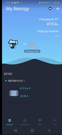

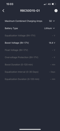

Parked up the solar has more or less filled the Li battery, showing 14.2 - 14.3 V, although only 48% SOC. Engine running screenshot and settings shown. I know I need to run Li right down to reset SOC, but since it is unreliable anyway I don’t see a need to do that, and I’ll use battery V. If I didn’t have the app, and just a voltmeter, I’d be blissfully happy!
agreed . . looks like battery is full.
