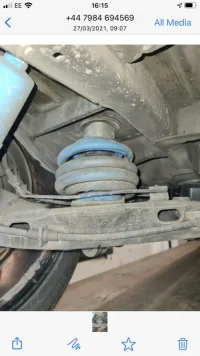

T30 rear bilsteins 14 20 inch wheels. This doesn’t look right to me . Should I have a smaller spring on . Or is this acceptable?
Hi Paul
that doesn't look right to me either. There should be a gap between the coils of the spring, as the spring compresses the gap closes, that gives you the wheel travel and your suspension, letting the spring and shock absorb bumps. That spring is almost coil bound so you have very little suspension travel before it all goes solid and will just bang and bounce around.

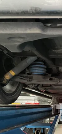

It’s a generic B14 issue unfortunately, here’s my rear spring and just the same - 50% of the spring is already coilbound, so all the future compression will need to be in the remaining free spring.
It’s why the ride can’t cope with small bumps, what should have been the ‘soft’ coils are already fully compressed so the remaining coils are stiff and very little movement.
There are some proper cowboy installers out there, who lets a van out of their workshop with a spring looking like that?
