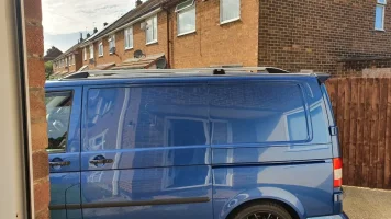

Just got mine off and redone today. Had to send a m6 tap down threads to remove old silicone. I still put dab of silicone on threads just as a precaution, but must say this mod is a must.....
