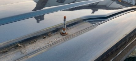

I thought I'd update this thread a little, as I have removed my roof bars for a colour change.
As you can see, the threaded rod has some surface rust, and, as others have suggested on this thread, stainless steel may be a better option, but apart from that, you can see that NO water has past the rubber washer and and penny washer, so it's proved a very successful way of mounting roof bars
