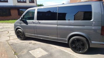

So I went for the Land Rover 19" wheels I was offered, very pleased with the look but still getting used to the ride and handling after 4 years on the standard 17" wheels
Still on standard height suspension but definitely fills the arches much better

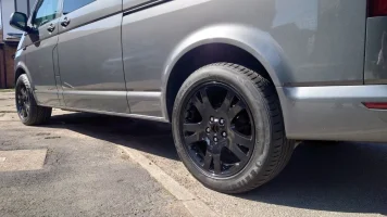

Am at a crossroads already with these and looking for some views
Took these out into the countryside and I think the 8.6% jump in circumference is too much for the transmission
Van feels a lot more planted but is less fun to drive, and on some steep 2nd gear climbs it was labouring whereas previously it wouldn't have been an issue
Should I swap the 255/50 to 255/45 so the increase is around 5% or will it still be a bit tooich of a grind for the transmission
Obviously a new set of rubber is going to be around £600 or should I go back to stock and look for different 19's with 45's on ?

Hi @Strettyp.
Sorry to hear you’re having these issues.
Which engine/gearbox and OEM wheel/tyre sizes did yours come with?
My T32 is 150bhp, 7spd DSG and came with 17” Devonports with 215/60 R17 tyres.
I realise knowing more regards the maths doesn’t help solve your ‘feel’ for the drivability, but I use wheel-size to compare wheel/tyre calculations, as it also allows for the ET offset, which helps regarding tyre rubbing issues.
I have estimated the Range Rover wheels at 8.5” rim and offset as ET 45 as an example;
This shows the increase as 7% compared with the 17”OEM setup;
Rim & Tire Size Calculator. Custom Offsets
Use the calculator to find other options which may help?
As you like the wheels could you maybe consider using a reputable used tyre dealer and negotiate a swap for four good used ones to tide you over?

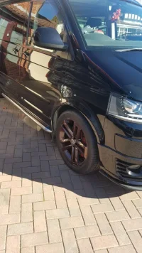

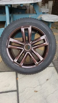

Sorry Andy, Genuine VW Amarok Cantera wheels 8j x 19H2 ET 43 5x120
Hi @Daz60.
Thank you for the details and pics.
The ET43 on 9 x 8j with the 255/45 r19 tyres make them look to fill the arches, without standing proud of the bodywork. This will all be of help to others.
What a great colour.
Look really good in your van.
