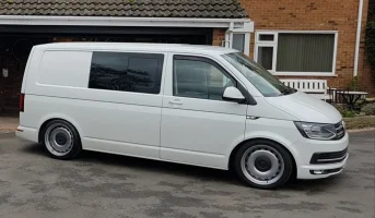

View attachment 36049 My 19s are on 245/45r19 rubber. (40mm lowered ).

Looks ace mate, what alloys aRe they? And lowered on ?
