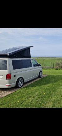

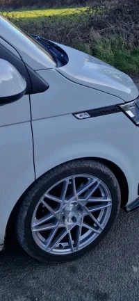

Any idea if this size tyre will rub with a 70mm drop?
It’s highly likely it will touch . That tyre is 10 mm bigger in diameter than the dreaded 275 40 20 and they touch all over at. 50 mm drops , the wheel offset plays a part here too , that will determine if it touches on the outside or the inside .ha han

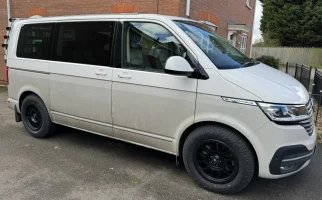

Just put tomahawk kato on our t6.1 velle exec with wildpeak 235/65/17.
Clearance for door card is literally mm but they fit no problem
