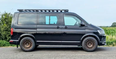

Hi they are just black nut covers on the OEM bolts
Just done 2k miles on the Falken 235s and they are great on the road not much off road action yet. Slight drop in MPG I think
Great setup! I’ve been looking at Kato wheel/tyre combos and 245/65/17 seems to be the default. Any benefits of 235?
In a nutshell, they won't rub and the speedo won't under read!
You can certainly get away with 245/65 but they may rub, especially if lowered (that's a another subject...).
Depending on wheel spec you could probably make a 235 rub to be fair but most transporter specific wheels seem to be ok.
235/65 seems to be the Goldilocks size and corrects the optimistic OEM speedo calibration for a 17" chassis.
