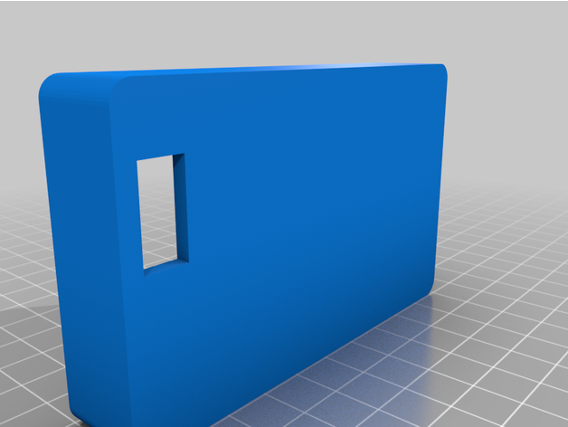

Need a mount for my renogy battery monitor and I’ve found this file on thingiverse but I don’t have a printer.
Happy to pay for time, materials etc

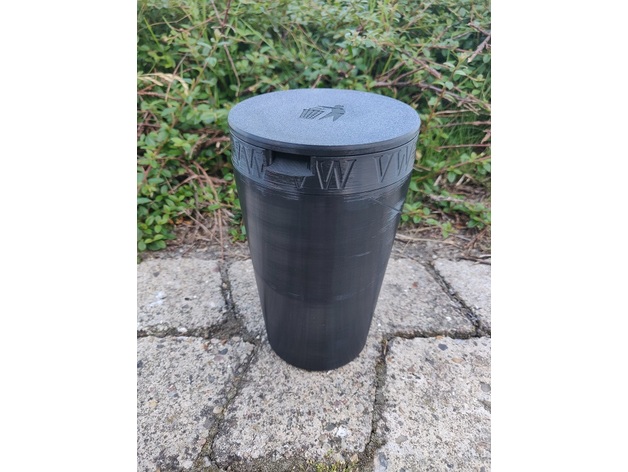

I just came across this 3D printable version of the VW bin, which fits in what I thought were large water bottle holders in the T6 doorcards :thumbsup:
I've no idea with 3d printing but that looks good......why are some really smooth and some have all lines in ? Somebody please educate me :p
There are 3 main technolgues.
One like a hot glue gun, with a desending platform. Google Ultimaker
One fires a laser into a power, fusing the material.
One fires a laser into a liquid and the build platform moves upwards out of the liquid. Google Formlabs.
The one I used is a Formlabs. It needs to print a support structure that needs to be cut off.
The Formlabs technology is great as you can print hard, flexible and rubber parts.
@MrTango thanks for the lesson cheers :thumbsup: which gives the best finish as yours looks perfect?
The smoother surface finish is probably because its an SLA print (the laser cured resin version of 3D printing @MrTango mentioned).
If it were FDM (molten filament deployed onto a print bed), even with ironing on the top layers it would appear rougher unless some post processing was applied (sanding, acetone smoothing etc).
