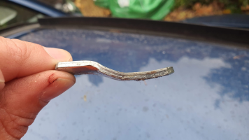

Unfortunately I'm also now part of the roof catch failure club (LWB T5).
It first happened when I lent the van to a friend who was absolutely convinced the catches were fully locked. I put this down to his error on not closing the latches properly.
It subsequently happened to me on the way up the M6 , I am absolutely certain that the roof was properly closed. The drivers side catch failed, I can't work out why. The additional strain on the cam/latch on the passenger side bent it, and also partially pulled out the small bolt holding the latch into the fitting.
Unfortunately on the side of the motorway I had no option but to bend the arm back into position crudely by bashing with the wheel brace...
My latches look identical to the post above, the roof was installed in April 2021.
I have contacted Skyline and have been very disappointed with the response from Skyline. I asked if I could purchase a new pair of lock assemblies, they refused point blank and directed me to the installer.
The installed also refused to sell these to me and advised that if I took the van to him he would install new locks, but won't give me a cost for the part and quoted 3 hours labour at £60/hr plus VAT. I won't name and shame now, but if we can't agree a sensible resolution I may do...!
I've determined that they are Southco E3-1410-091 fittings. (Reference on the bag in the Skyline Aurora installation video!) but haven't found a stockist yet - anybody else got any ideas?
These latches seem to be designed for service cupboards and electric meter enclosures rather than a pop top roof, and are entirely dependent on short M6 bolts holding the latch into the mechanism.
Unfortunately I've now lost trust in the catches. I plan to replace them as soon as I can get a replacement, but I would also like to fit something as a backup... possibly like the webbing somebody mentioned above.
If I can find anywhere to order some replacement catches would anybody else like a spare or two? I'll probably end up paying more postage than the cost of the parts!!

A update for anybody that is interested.
No further response from Skyline or the installer. Have tried calling both and have sent a further email with photos and videos today. Not sure why I'm not receiving the top end customer service that Skyline seem famous for!
I spent a bit more time investigating at the weekend, see photos and video links below.
My analysis / conclusion / assumptions:
The whole mechanism relies on 2 M6 bolts, see first photo, to hold the cam in position. These should have been fitted with threadlock, but don't appear to have been. They presumably worked loose, allowed for a bit of movement and air to get under the pop top, bending the cams and allowing the roof to open.
There is also significant 'play' in the main both of the latch.
Ultimately I would question whether this whole assembly is fit for purpose.
