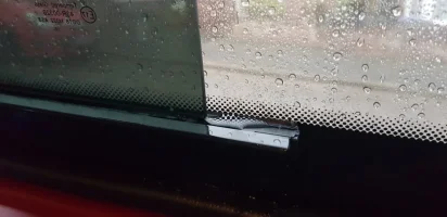

Now seeing my slider leaking more and more it appears that when shut it’s not tight and can be pushed away from seals. Is there a way to adjust this? Nearside is fine, nice and tight when shut but offside I’m suprised it doesn’t rattle! Thanks
Yes sadly it is a common fault, had both mine replaced under warranty for leaking, lots of threads on here about just do a search

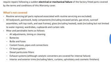

Hi Folks,
Just a warning to others out there that the leaking windows on my 2016 Kombi aren't covered under the 'das welt' extended warranty.
So 3.5 years is an acceptable lifespan of the window seals!

Take the bottom trim off the slider and find out where the leak is. 90% sure that it will be a poor joint between the two parts of the drain system. Test by fitting the narrow end of a mastic tube nozel into the drain hole and pour water in, usually runs inside not outside!
It should be fixable with some sort of mastic around the joint between the two parts. Remember that each window has two drain holes, the centre one can only be seen by romoving the sliding portion.
I've given up trying to get VW to supply ones that don't leak and will be trying the above fix on my current T6 soon.
Thanks rod_vw, I'll have a look at what you suggest at the weekend. Always park on a slight hill so the drain holes at the middle are probably blocked as water runs from the inner plastic channel where the glass slides, to the back of the doors.
