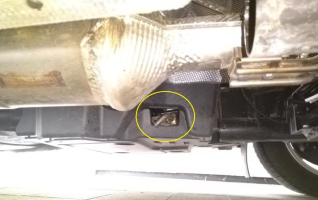

To me sounds normal at subzero temperatures - if your van does not have auxiliary coolant heater. Do you have Webasto sticker on driver's door? If you do have the sticker, the auxiliary coolant heater doesn't work.
150 T6, 5 mile commute, any cold outside temperature and its at 90`C (just) by the time i park it for example. I do hold it in a lower gear to help it warm up a bit quicker, but the gauge is climbing all the time.
I can't see anyone putting a sticker on to remind you to switch off the heater at refuelling without a heater being fitted. Look the other side for an air heater.
Thinking about it..... I'm wondering if my converters stuck the sticker on when the van had the diesel heater fitted! I'll have another look under the van tomorrow.
As a matter of interest, I assume that these aux coolant heaters work without any interaction from the driver?
Mine has the same sticker, Webasto added during conversion.
