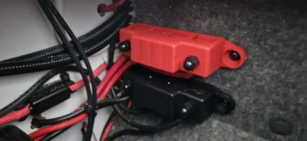

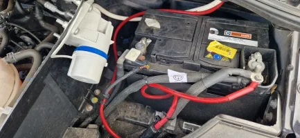

These are the photos of my setup. Same thing happened today after one night camping off grid. Only thing running was the fridge.
CTEK seems to be working shows when solar is charging LB or VB, and also 14.4v on the LB monitor when engine is running.
Work carried out is in the photos (apart from LB itself as that's under a panel.
The job was to relocate the LB from under the bed next to a gas locker to in the cupboard over the wheel arch. Then to take off all accessory cables connected to LB and reconnect via busbars (as in photos).
Solar installed and cables shown coming down into through the back of cupboard. Solar connected to CTEK.
Victron only comes on when on EHU, but this didn't stop the issue before.

An easy way to see if the problem is being caused by the ctek is to pull the fuse between ctek and SB.

In fact, it’s hard to tell in your pics, but it looks like the thin red wire actually goes through the hole in the unit. I was just thinking that maybe they hadn’t reconnected it if they’ve disconnected the ctek for any reason when carrying out the upgrades.
One way of eliminating the new work as the source of the problem would be to disconnect the only link between the leisure system and SB ie the cable between SB and CTEK. Pulling the fuse in that cable would be the easiest way to do it safely.
I’d think it’s the one in the midi fuse holder in the red cable near the SB shown in your picture.
