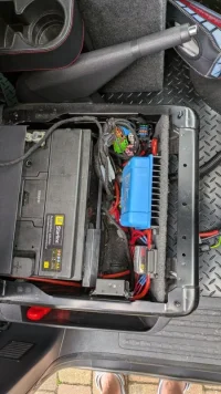

So I finally got the time to add the MPPT.

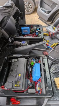

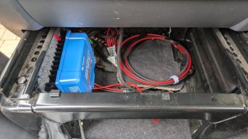

Thanks to everyone that helped answer my questions. I didn't have enough room under the drivers seat so had rlto route the battery cables to the passenger base which was surprisingly easy.
Bit tight for space
Cables pulled though without a snag

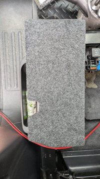

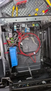

Made myself a panel to fix it to and added a bit of carpeting..

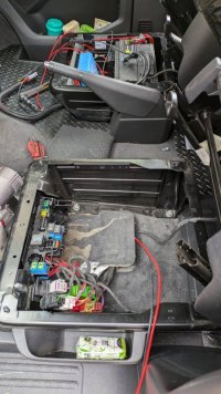

Power connected and paired in the App
And tails all ready to connect to the PV leads

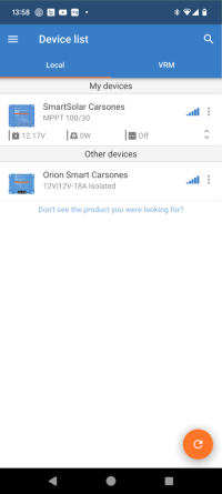

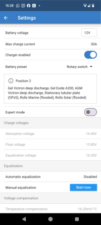

I only have a Starline 100ah sealed lead acid battery. Does this look correct? Screenshot_20240628-152833.png
Cheers
