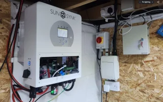

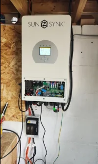

SUNSYNK 3.6kw hybrid inverter with Pylontech battery storage.
i added another two 400w panels - so now 1600w on the roof.
then swapped out the inverter to the Sunsynk one. . . .
and added 4x 2.4kwh (9.6kwh) storage batteries.. . . . . .
but. . . then had to upgrade the feed to the inverter to handle 3.6kw.

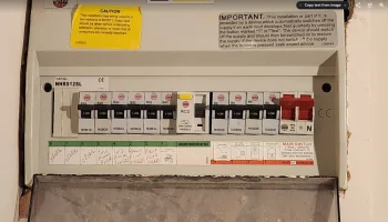

and started to get random RCD tripping from my older consumer unit. . . . hmm.
a quick EICR electrical report showed that the old split load CU needed to be replaced.
out with the old . . .
in with the new . . .
new RCBO CU, plus a remote CT clamp + meter for the Inverter.

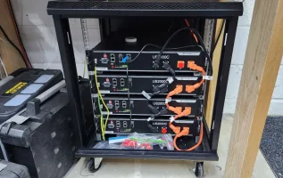

getting the batteries connected. . .
we have power . . .

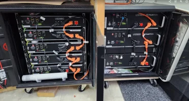

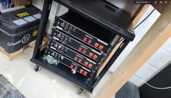

Time to beef up the Domestics Solar setup.
the other 4x 405w panels added:
doubled the battery storage capacity now 19.2kwh :
sticking with the 3.6kw Sunsynk for now:

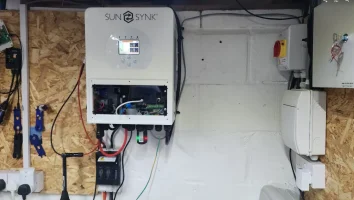

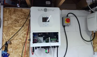

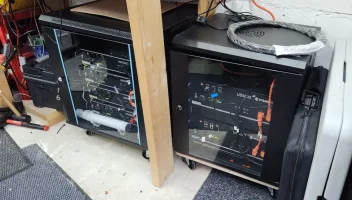

in with the new.
3.6Kw swapped out for the 8.0Kw model.

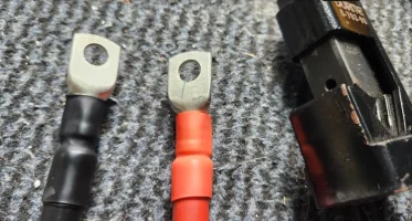

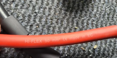

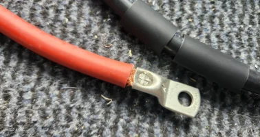

new 50mm2 - 200A DC feed cables made up . . .
i uprated the 100A fuse to 160A for now. . . thats the MAX this fuse holder can take. ( the inverter can deliver/request 190A max, so ill set the limiter for now)
I've ordered the 200A fuses and fuse holder, but that for another day. . .

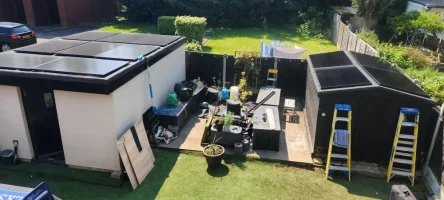

more panels added too . . . now we has 12x 400w on the shed roofs.

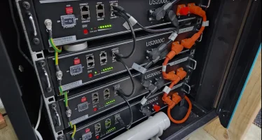

battery still the same. . . 25Kwh
in with the new.
View attachment 259613View attachment 259614
View attachment 259615View attachment 259616View attachment 259617
Mental set up Lee.
Looks amazing
Bloody hellfire :cool:

With 25kwh battery storage system.

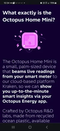

Octopus Energy has a fix for that....
They send out a small USB powered PUCK.
That connects locally to your smart meter... And your local WiFi.... Then beams all the data back to them.
I've got one indoors
Gets you live updates on your power usage every 10sec and live history of 5 and 30mins....

Apparently it's down to the smart meters working the old 2G and 3G radio networks that are being switched off.
So the local puck gets a new path back to the energy company servers.... Happy days.
We was having issues with them reading the meter remotely for the live IHD data.... Now all sorted.
