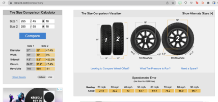

Heading back to South America for the 3rd time, but first time with a van. I'm purchasing a T6.1 with Locking Rear Differential (1Y4), though they seem to come with 255/45 R18 tires. The problem is BFG and the other major companies don't seem to make an All Terrain 255/45 R18 tire, or similar size.
Some people use the 255/55 R18, but I've read the spare doesn't fit underneath - this is not an option.... Do I need to get different rims??
What other size All Terrain tires/rims would work well, and still fit the spare wheel well below?

I have 245/65/R17 BFG's on my T6 with no suspension mods. A fully inflated spare fits underneath with a small mod to the carrier and plastic tray no problem and they are a larger diameter than the 18's and only a bit narrower. HTH

Thanks. They look pretty close. What do you mean by "small mod" - just a bit of filing down, or...?
