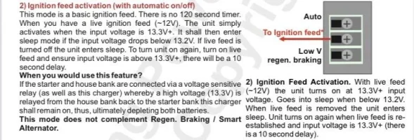

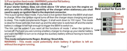

So I've just to sorting out the charging side n my van. When i bought it i spotted a stirling bbw12120 under the seat.
5I659yy.jpg I have read the manual and its currently set up like this
but based on reading this i think i should change it to this:
any advice, pros/cons etc? Cheers
