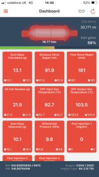

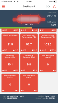

I cleared the code myself, and it came back after a few hundred miles. The soot level was around "12" I believe at the time I checked the code.
I put it in to a local (independent) garage who replaced a sensor in the DPF but weren't optimistic and said it's likely the DPF has failed. Sure enough, a few hundred miles the EML came back on. It's like it comes on at a set distance travelled since it was cleared.
This is what DPF Monitor shows at idle:
Oil Ash Residue as %

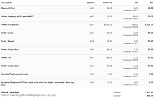

The (independent) garage are now saying it will likely need a new DPF and the quote given is as follows:
![1719342042296.png 1719342042296.png](https://www.t6forum.com/data/attachments/247/247230-8ed6c71c4806a1988b46ab27886e9403.jpg)

- If the DPF has failed, is that price for replacement reasonable?
