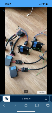

Headlights and headlight power modules (1 per headlight)
Levelling control module
Front and rear level sensors
Wiring loom to connect it all up
followed by lots of coding/adaption channel tweaks

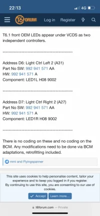

Hi , the van has all the level sensors etc , the I’ve got the main beam working however struggling to connect on the canbus, the 2 addresses of the lights I’m short of d6 and d7 are not showing on the van gateway installation list so looking at trying to add them , I’ve a set of the old t6 led so may go down the route of using the the internal cables and module for the high beam , side light and indicator but just trying a few things and doing a bit of research first, I’ve seen 2 people so far that have done this , I’ve found the link to morzze modules so I will try buy them

Can you post your current VCDS AUTOSCAN?

Hi Robert , yes I’m back working it again this weekend so I will get a copy of it, my vcds computer is not connected to an email so I will take some pic off my phone of it and post it up , it’s a genuine vcds latest update so should get all information.
Hi Robert, here is the scan , both headlights are unplugged, the van has an after market radio in so that’s the missing module on the van install , as said before I’m not 100% sure if the current bcm is capable of talking to the modules on the headlights , I will post what I think they should be installed as
