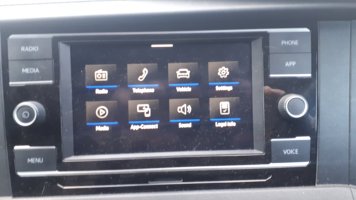

Ok, so after a little research and trial / error...I’ve managed to find a definitive answer as to how to do it. What you’ve been told is correct with the addition of one extra bit...
To summarise,
19 - Gateway --> Installation List --> Activate "6C-Backing up camera" --> Save
5F - Electronic System --> Adaptations -->
CAR FUNCION LIST BAP GEN2-VPS-----ACTIVE
CAR FUNCION LIST GEN2 - VPS msg bus -------TERMINAL 15
10 - Steer/Park Assist --> Byte 4-5 --> 10 Rearview Camera

Your cable is out of date you need a Hex net to do late T6 onwardsHi, I have fitted a Genuine VW rear camera to my 2021 VW T6.1 and I'm having an issue with the coding. The instructions state Execute the following coding • Address 5F: Byte 19, set bit 4 to 1. • Address 10: Byte 0, set bit 5 to 1.
When I connect my genuine Vagcom Hex Can lead with the latest software running the section is greyed out and there is a message saying module not supported. I am stuck and any help will be really appreciated. Thanks
Thanks at least that saves hours of wasted time. I now need to find someone close to Chester that has the leadYour cable is out of date you need a Hex net to do late T6 onwards
Hi have you got the correct lead? If so could you do it and where are you based?Your cable is out of date you need a Hex net to do late T6 onwards
Hex net will do the job, it may prompt you to open the bonnet to let you into the controllerI am reading that as my van is 2021 I might need a Token to get through the firewall that VW have added to the system. Has anyone else had this difficulty? If so how did you get around it? I would buy the Vagcom Hex net lead if it was 100% going to code the camera but don't want to go down that route if it won't work. Any help is appreciated.

Great thanks. I have ordered the nee lead. Fingers crossed it worksHex net will do the job, it may prompt you to open the bonnet to let you into the controller
I’m in Shrewsbury and can code it in for you if you’re in the area anytime soon (if what you’ve ordered doesn’t work).Great thanks. I have ordered the nee lead. Fingers crossed it works
