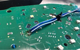

Maybe the following is interesting for one or the other.
I have a T6 transporter without automatic light. I also have the digital display and the Discover Media as a head unit. I had noticed lately that the head unit was much too bright for me at night, and it could no longer be dimmed with the rotary wheel. Then I remembered that I once read something about a sensor on the board of the display unit and that it would control the radio via bus in addition to the instruments. So I looked at the removed instrument cluster again, and yes, there is a hole and something like a lightguide!
Ok, removed the board and checked it, and indeed, a sensor on the board right behind the guide.
Sensor soldered out, laid out with the help of a pair of cables, and everything works perfectly again.
The radio can be dimmed again, nothing dazzles in the night. How it behaves during the day in the sun, I will test tomorrow. Perhaps our chinese friends have to think about a solution for that....
