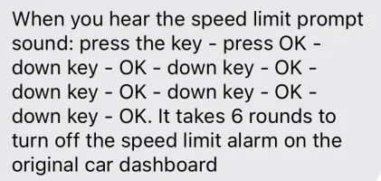

just received mine and got it up an running, Very impressed! the screen quality is superb. Only issue I have is apparently there is a speed warning set at 59 mph somehow, even though the setting seems to be off... is this the multiple down/ok thing???

In the Menue ( “calibration” if I remember right ) scroll down to reboot and confirm rebooting
Then the speed warning should be gone

What vehicle ?
If you had a T6 Highline cluster 100% follow my guide on how to clear speed alerts on my website in the FAQ section.
If you have a 6.1 you should clear in advance from the head unit settings under vehicle. Then you multi function steering controls can never touch it.
Startline I believe the 5*((down and ok)*9 times, then right) should fix you.

Please could you elaborate on this Startline sequence Antony? Not seen this before.
