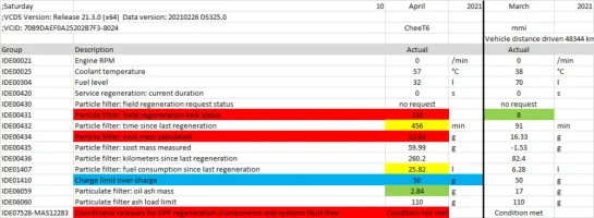

Thanks. I compared your data with mine (though only having 48000 km on).
The following stick out. I believe the "Charge limit" is the thing here - the soot mass (calculated) now exceeds the maximum and thus presumably preventing DPF regeneration.
However, the mystery remains why the regen didn't happen when it was due - at 30 grams of soot (calculated). Were there faults at that time?
Looks like DPF oil ash mass has been adapted so the ECU believes it has got a new DPF recently.
Anyways, I'm not sure what's the safe way ahead. Would adapting soot value in basic settings do the trick or just set van on fire :oops:?
Wow thank you mmi, yes it looks all very high doesn't it, funny as the soot levels were below the 50 threshold when this issue started. i didn't have any faults until last week and that was just the coil and engine management lights.
We have recently done a few short journeys but not many tbh. And as for the oil ash mass value being changed that wasn't me so that's strange.
