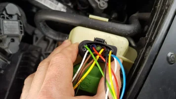

I have reused the following wires & terminals from 10 pin plug: number(3, 5, 6, 9)
and on the existing wires for DRL and high beam I crimped small terminals of the 14 pin plug.

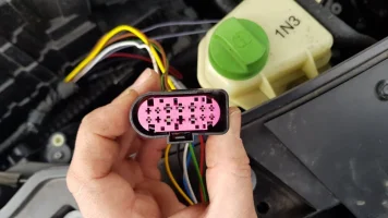

In the above photo terminal for DRL PIN10 is not plugged in yet.

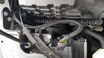

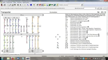

For terminals (1, 2, 3, 4, 10 & 14) of the new 14 pin plug I have used my new 6 core cable and I ran it to the BCM area under the dashboard.

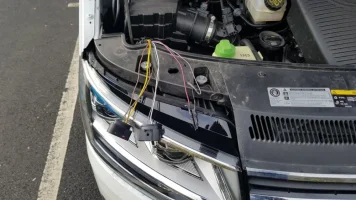

In order to reuse the existing wiring for the LHS headlamp I had to change slightly its route.
Basically on LED lamps socket is higher than on halogen lamps and I had to gain somehow on cable length.
