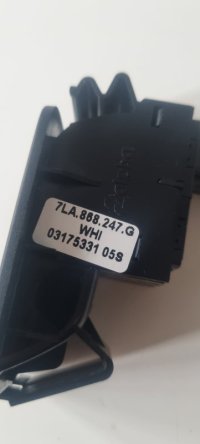

I've got a Kombi with the electric opening tailgate (not just power latching), but has no way to open it from the inside, so I've been looking at wiring something into the external release switch as per the existing posts.
However, I've managed to get hold of an OEM switch (i think its from the drivers door from a Caravelle maybe?) - but have read that those have a 180 ohm resistor in them (and my multimeter shows resistance between two of the pins when the switch is activated) so I assume you cant just wire that in to connect the wires for the existing rear release ? - as they are designed to connect to the can bus?
I was thinking I could wire it into the same pins as the open/close button on the internal bottom of the tailgate - but that is deactivated when the tailgate is shut - so not much use!
The external handle however does both open and close the tailgate however - so that is the ideal one to wire into.
Is the electric tailgate opening switch different to the power latching one? Would it be possible to simply piggy back off the external handle - or does the resistance prevent that from working?
If not, would it be possible to solder part of the PCB in the switch to bypass the resistor ?
Or is it easy to wire this switch into the existing loom somewhere so it works as it would if it was factory fitted?
Anyone done this?
Also - does anyone know where to get the plug for the wires to plug into it? its the same as the electric window switch plug...

Managed to solder a bit of wire over the 180 ohm resistor so now get continuity across the pins when pulling the switch - so now can install it like any usual switch as per the existing guides...

Actually the BCM distinguishes the switches inside and outside of the van by this 180 ohm resistance. The switches (0/180 ohm) indeed are wired in parallel.
To enable this functionality BCM coding needs to be altered.
Byte 02-6 = "1" : Tailgate internal release button installed (verify status in measurement block 008-3 before and after the coding change)
Byte 01-4 = "1" : Tailgate opening with internal switch enabled
Anyways, the above works for standard tailgate - per wiring diagram should be the same with electric tailgate, too.

@mmi - Sorry to resurrect an old thread, just wanted to double check that its 180ohm not 180K ohm.
The image looks like its 180K only asking as I'm about to wiring up an internal switch.
